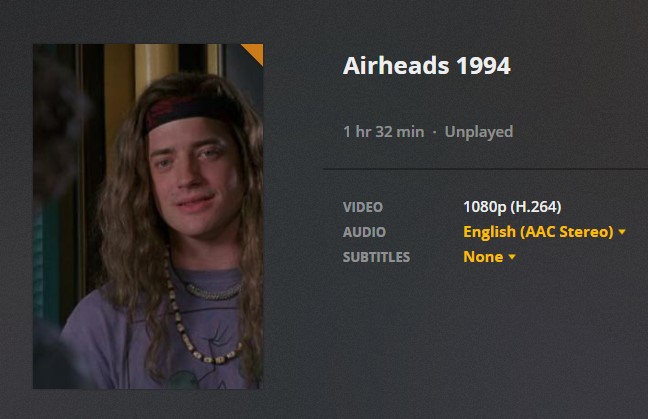

In regards to the air heads 1994, I’m not sure where it’s getting that info from. I don’t have listed like that and when I checked the properties in windows there is no metadata added to this file. The only thing it could read that from is the folder but I have tons of movies with folders like this that it doesn’t pick up the folder name.

Screenshot_26

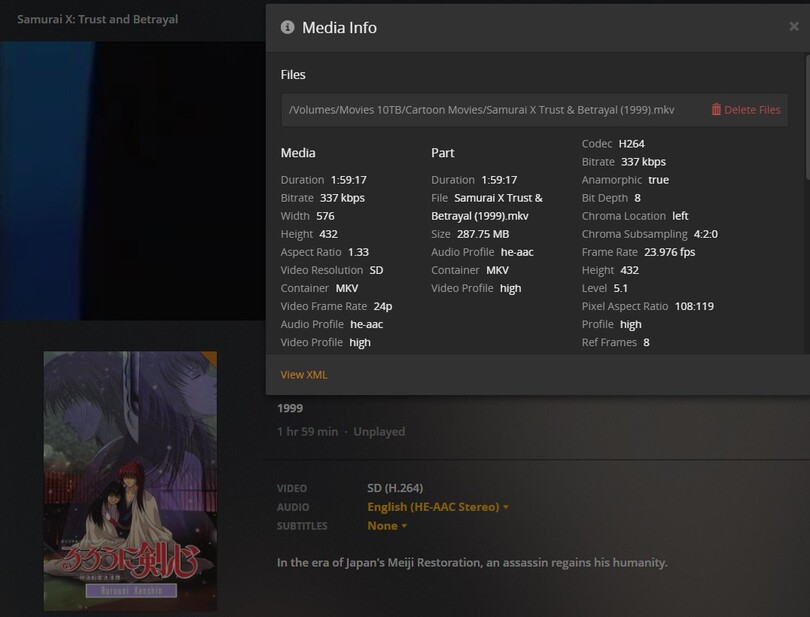

Here is another movie that is stuck even after the plex dance. It’s not in a folder and the other Samurai X movie came up without issues.
Movie: Samurai X Reflections
File Path: * /Volumes/Movies 10TB/Cartoon Movies/Samurai X Reflection (2001).mkv
Edit: So I have two movie folders. Cartoon Movies and Movies. Cartoon movies isn’t looking at the local media assets. Movies is. I have a folder in Cartoon Movies called Robin.Hood.1973.720p.BluRay.X264-AMIABLE and it picked it up just fine without issues. Every movie that is having issues in “Movies” has an odd folder name or has the year not in parenthesis. I think at this point I should just do a clean install of Plex and start over.

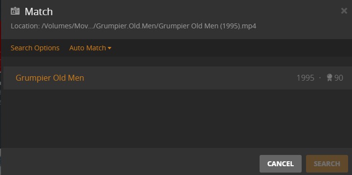

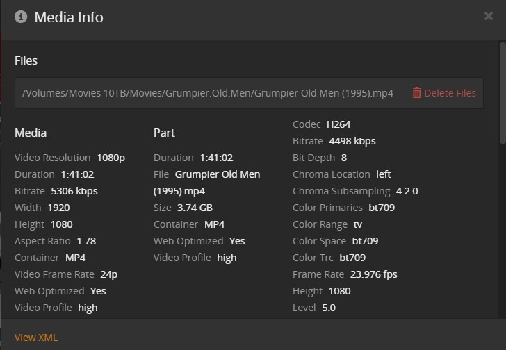

Make /Volumes/Movies 10TB/Movies/Grumpier.Old.Men/Grumpier Old Men(1995).mp4 into /Volumes/Movies 10TB/Movies/Grumpier Old Men(1995)/Grumpier Old Men(1995).mp4
I suspect you are confusing the scanner by having the movie in a directory, that doesn’t follow the naming guide, even though the file inside it does
See: https://support.plex.tv/articles/200381023-naming-movie-files/

Samauri X Reflections is a good example. I had it just sitting in the cartoons folder with the proper name and it was fine just like the other Samurai X movie right next to it. After the scanner went nuts it broke this movie but not the other one.
Since then I’ve done the plex dance with it, put it in a folder correctly named, used filebot to name it, and removed all the metadata (which was correct but I removed it anyways) and have deleted and rebuilt all the libraries in Plex. This is what comes up. Fix match finds the movie but it never updates. It’s just stuck like this. Clearing bundles, optimizing database, empty trash has no effect.
The other Samurai X movie is not in its own folder and scans without issues.

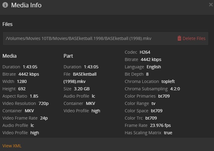

Predator (1987) Doesn’t pick up and gives me the screengrab as a backdrop. I know the folder name doesn’t contain the date. The majority of my folders do not contain the date in them.
I thought for some reason this was reading the title in the properties of the file. Which I had issues with when I first setup Plex and when I dragged local media assets to the bottom of the agents list for all of the agents it fixed my issue on the next refresh and didn’t look at this info. Predator seems to pick this up for some reason vs using the title FileBot gave it.
Predators (2010) also doesn’t have the year in the folder name, and has info in the properties but it didn’t have issues picking this one up.
When I first setup Plex a long time ago local media assets was on top of all the agents in settings and this file would come up as When I had local media assets on top it would have named this movie “Predators.2010.REMASTERED.1080p.BluRay.H264.AAC-RARBG”. I had to “fix match” on a lot of them until I learned about dropping local media assets to the bottom of the list and refreshing the data. Once I did that it was all fine until I reported the issue.
