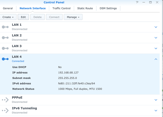

Not sure what to fix though, see screenshot
Do you see what’s happening?
You’ve set port #4 as te default and are reaching out to an external DNS server.

did I do it correctly?
The IP is my router’s IP address: 192.168.68.1
Yes.
That part looks good.
Now go to Control Panel - Network Interface - Eth3 (LAN 4)
Make sure it it setup for your LAN (similar to how mine is) or use DHCP
this is what I have now

Got informed of this post. I’m not a NAS expert, but I do see a few odd things that might help.
I saw your other thread, Server cannot be found. I think the info is getting spread out so I’m closing that one so we can focus the efforts here.
In your last screenshot you posted the ipv4 setting. There you used a different DNS server. Set that to the IP of your router. Then try the claim it tool again. From your other thread, you had the wrong IP address for the server. It should match the one from your screenshot above. 192.168.68.127
