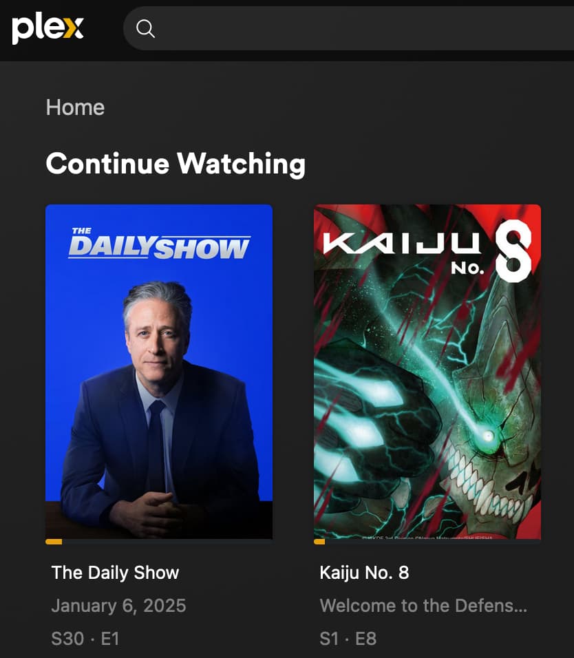

Plex server does see that the file has been played partway so it’s keeping track of the resume position just fine - the continue watching marks are from me skipping ahead on those devices and closing out playback right after it restarts.
