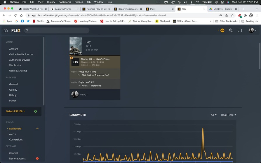

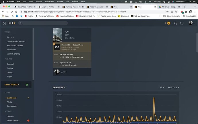

I made sure to configure my server for debug level logs. I DO NOT have verbose logs enabled.
I streamed the movie “Fury” on my iphone over cellular network and it’s showing that it’s streaming locally but that’s not possible. Also, shows a yellow exclamation mark.

Oops, I see a tiny yellow (!) in the upper corner. Point at it. Does it say that it is using the relay? If so, then you might not have the server correctly configured for remote access. Oh, and now I see the red (!) in the lower left, next to Remote Access. Meaning you have a config issue.
The Plex relay is a last-ditch effort to get a remote user to connect to your server if the network settings are not properly configured. Since your server has punched an outward hole in your network (most networks allow outbound, but block incoming) to the master PLEX company servers for… reasons… your server can piggy-back on that connection to also do video. But it goes through the company’s site, which costs them bandwidth. So they restrict connections using the relay to 2 mbps or less.
I pointed at the yellow (!) and it says “indirect”. It doesn’t say relay. But is that the same thing as what you’re describing. It certainly would explain it. How do I fix this?
Note: I’ve never had any problems with Remote Access until I switched internet service providers. I now have ATT Fiber. And it’s really been a headache trying to get remote access working properly since.
Oh, indirect is the term it says, not relay? Well, it’s the same thing.
