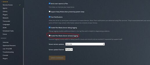

Please turn off verbose loggin under Settings>General>Enable Plex Media Server verbose logging
Plex Media Server Logs_2021-09-30_11-42-48.zip (1.2 MB)
Verbose turned off.
Sorry, but I’m still seeing verbose logging. Could you please restart Plex media server, reproduce the error and upload log again
