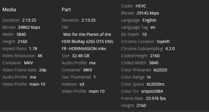

File that is making the problem:
and here - <Media id="11978" duration="8005351" bitrate="34862" width="3840" height="2160" - Pastebin.com

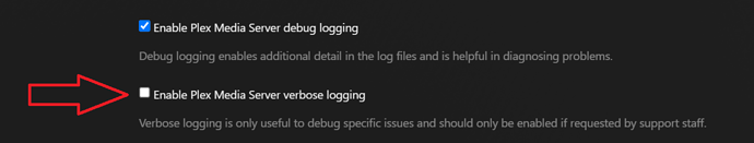

Ugh. You have verbose logging enabled. Please turn that off and restart PMS. Repeat the steps above. It’s easier if you just get me the zip file of the logs.
Sorry,
here it is - https://store1.gofile.io/download/2e4dfa76-ad56-4713-b738-46706ddc97f4/Plex%20Media%20Server%20Logs_2022-12-15_06-20-40.zip

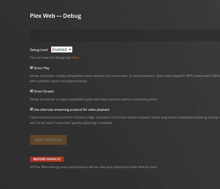

Although, I think verbose is still there, no matter the fact it was disabled in the settings
Wrong setting. That’s for the Web client. Go down further to the other “General” tab.
You want debug on, verbose off.
Oh, yeah, I see now, this one should be the needed one :slight_smile:
Thank you.
@GG30 Verbose logging is still enabled (look at Plex Media Server.log).
You have to restart PMS after turning off verbose logging for the change to take effect.
Please do the following:
  1. In the Plex Samsung app, enable both direct play and direct stream(*).
  2. In the Plex Samsung app, enable logging to server at the debug level.
    This times out after a few hours, so you may need to re-enable it.
  3. Verify verbose logging is disabled on the Plex Media Server.
  4. Restart Plex Media Server.
  5. Wait 2 - 3 minutes for PMS to fully start and the log files to capture the startup.
  6. Play the movie on the Samsung TV to re-create the problem.
  7. Stop playback.
  8. Wait one minute for the server to log everything.
  9. Pull & post server logs.
Note: Drag the zip file into the forum message window. It will attach at the cursor location. No need to use Gofile.
(*) Disabling Direct Streaming may force a video transcode, which kills HDR.
  • According to the info you provided above, War for Planet of the Apes has DTS audio.
  • Samsung TVs do not support DTS audio.
  • Therefore, it will be transcoded by Plex Media Server to a supported format.
  • This results in PMS direct streaming the movie.
  • If Direct Streaming is disabled in the Plex Tizen app, Plex Media Server will then transcode both the video and the audio.
  • Plex transcodes all video to H.264. If enabled on the server, Plex will tonemap HDR to SDR.
