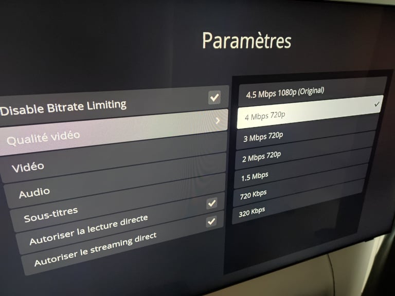

I will send some pictures soon to show my settings.
  • just for information: my TV is linked with cable to internet. My PC is in wifi.
video settings:
272159393_4942329469158723_2856359788782004572_n
If the sound cut:
sorry its in french ^^
You can’t limit the video quality when the server has ā€˜video transconding’ disabled I think.
Yes, its true,
Sorry I make a mistake. ā€œvideo transcodingā€ is not desactivate at home.
Why did you desactivate it?
All my videos are readed directly ā€œwithout transcodingā€.
That’s transcode only if a change the quality
Normally, you disable that option because you don’t want to fry your server’s CPU.
oh! ok. thanks
