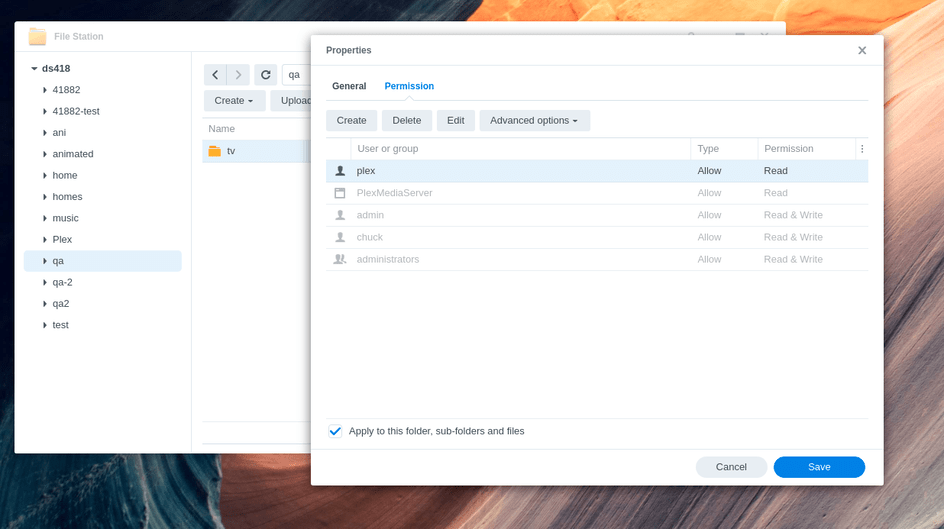

Getting 2 of several, even without metadata is most likely a permissions problem.
Linux is very strict. User plex must be able to read the files.
If you copied them in over the network, be careful how you set those permissions.
“Everyone” being able to read is the easiest to implement.

Did you apply the permissions recursively to the files in the shared folder?
There are cases where the share gives permissions but the folder down deeper does not.
I use this technique to add permission for Plex to read everything.
