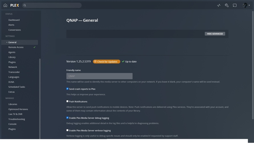

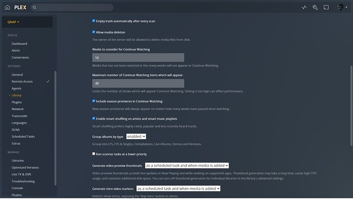

Hi Guys I need your help please. I am really new to Qnap and I looked everywhere but I can not find any fix on my issue. Basically I have Qnap TS853A with latest Plex server: 1.25.2.5319 installed but my Libraries are not updating at all when I add new pictures, shows or movies or music I have to force it always to see what I have uploaded. I tried everything from your forum or outside the forum but still nothing I have to force it always. I have also tried to wait for the daily maintenance which I have setup but still nothing or change settings to recommended by people (look on attached pictures) but still the same outcome they will not update automatically. When I first installed the plex server couple of months ago it was working great but now after last 2-3 plex server updates it did stopped working and I have tried reinstall the server completely and start from scratch but still the same outcome. I have also read lots on forums that this is still ongoing issue with plex server. I do not want really to setup like forced scan every hour or something like that to cause wear on the drives. Could you help please I am going crazy really.
