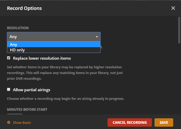

Have you checked the settings then for The Rachel Maddow Show? From the log message I am guessing you have HD Only selected in the Advanced options and the show may not be reporting it is HD in the guide data.
Interesting… so you think the guide data is no longer reporting all these shows as HD?
And interestingly, as it turns out, the one show that seems to be working, I left the resolution as “Any”… well that’s annoying… thanks, I think this was likely the issue!!!

I ended up finding the cause of the issue I was experiencing. The shows which were not recording were set to “New airings only” instead of “New and Repeat airings”. So that is good.

@stang9550
Your workaround worked for me. Hopefully they can get this fixed. Thanks!!!
@hevc4ever No problem, glad I could help
This is the solution that worked for me as well. Thank you Stang.

I ran into a similar issues on my Windows bases server running Version 1.13.8.5395. All my recordings were set to HD and showed no upcoming recordings. When I changed the settings to Any as @stang9550 they all showed in the schedule again. Today I wanted to double check it was still working and noticed The Walking Dead was not on the schedule. I went to the guide and it was showing as a new airing as that is how I have it set to record. I changed the setting from New Only to New and Repeat and the new episode showed up on the. There’s obviously something going on and wish it would be addressed.
