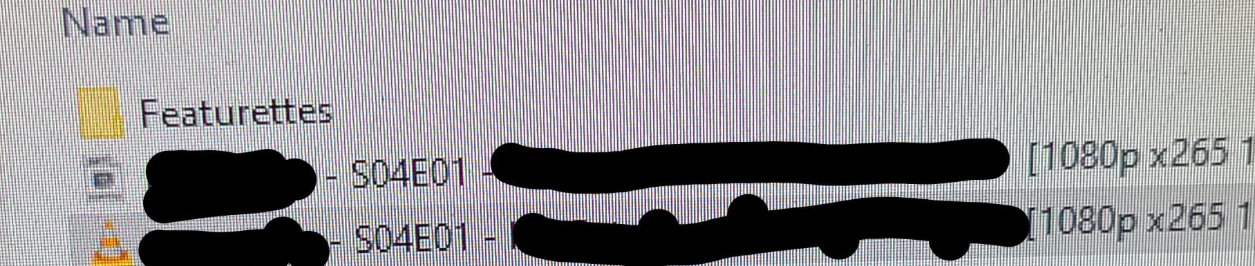

Do have a leading zero to your episode numbers that are only single digits, ie:
s04e01
s04e02
s04e03
etc…
I would do it for both season and episode… After renaming, do another plex dance
Yes, I don’t know much but I do know that.
