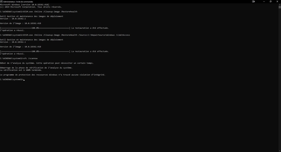

  • run MS System File Checker
  • reboot the computer if sfc does anything

here’s my SFC that show no problem, a picture of how I disabled IPV6 (I turned off all other network card) and “new logs”
