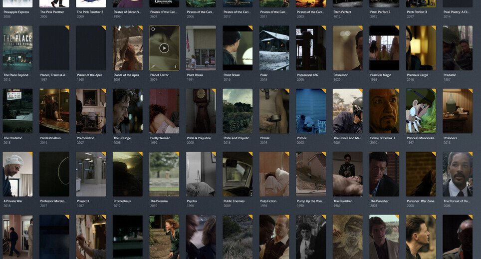

just look at this mess. I didn’t even touch this library. I have other libraries also untouched now with multiple unmatched content.

it gets worse though, here’s movies.
