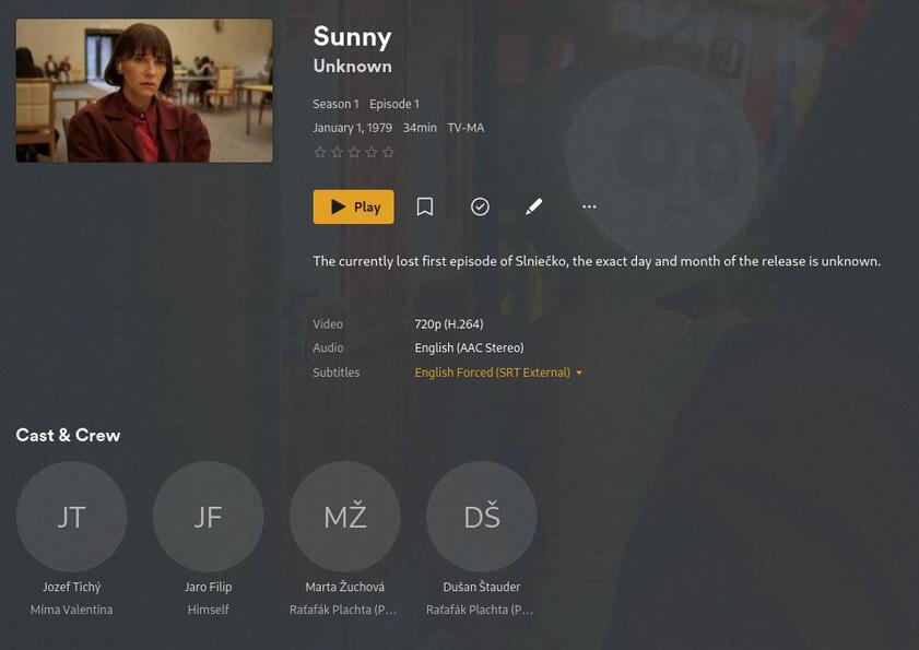

This new show Sunny (TV Series 2024-2024) — The Movie Database (TMDB) is getting some very weird metadata in plex. See s01e01 metadata below:
Notice the air date of Jan 1st 1979, the title, summary, overview and cast credits. Initially, as the show is new I thought it was just the usual wait for the plex metadata to catchup with the online sources, however so far its not fixed itself.
So I done a little digging and I can see at the show level this series has multiple tmdb ids (see below taken from show level xml data):
<Guid id="imdb://tt18070898"/>
<Guid id="tmdb://105298"/>
<Guid id="tmdb://157226"/>
<Guid id="tvdb://415975"/>
The first one in the list goes to Sunny (TV Series 1979-1979) — The Movie Database (TMDB) which is incorrect and matches the metadata above whereas Sunny (TV Series 2024-2024) — The Movie Database (TMDB) is the correct one.
Can someone from the metadata team review this on their back-end and do a cleanup to remove the bad id.
I’ve filed a report.

Any update from the report ? I’m still seeing this issue and its not resolved after multiple plex dance attempts.
I don’t think this is regional since I’m in the US and seeing the same thing. I even tried to fix it using a plexmatch file with hints to the correct info and it’s still using the wrong info.

Okay, I bet it’s a tmdb episode ordering problem which is why it’s working for some. I’ll check later when I’m back at my pc and adjust the order on the the show as a test.

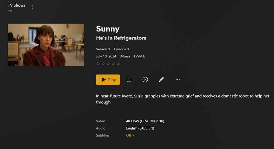

Here is the information from doing that.
-Shark2k
Thanks, that pretty much confirms it as its identical to what I reported above.
Confirmed - changing the episode ordering to tvdb (aired) gives the correct titles and summary for the episodes, however the cast is still from Sunny (TV Series 1979-1979) — The Movie Database (TMDB). I’d say its the same for you but would be worth checking.
