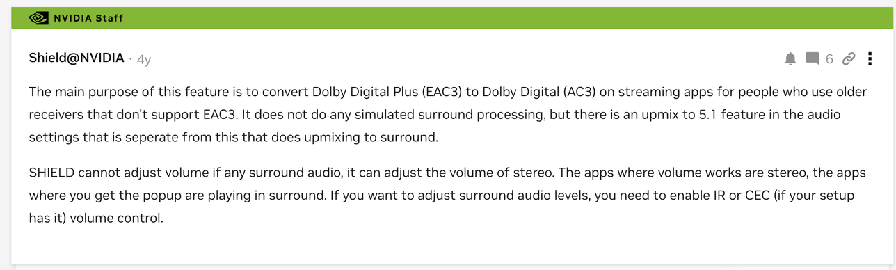

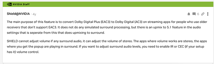

Found this thread which seems to indicate that option is a bit odd so mileage might vary but consensus is that for Plex, having it off if connected to devices that can process dolby itself is the way to go: Reddit - The heart of the internet
This post in nvidia forums about it clarifies (linked in that reddit thread):
