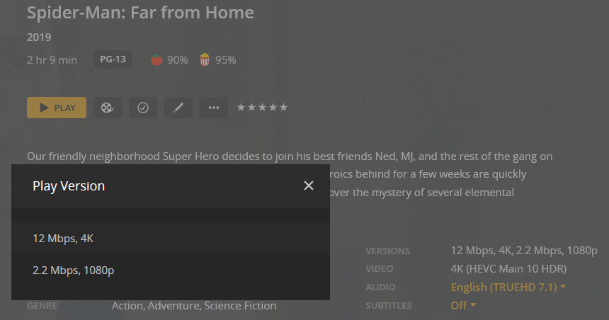

Happiness! :grinning_face_with_smiling_eyes: I did as you recommended and now the 4K version can be seen along with the 1080p one.
I’m keeping both versions because there are a couple of devices that cannot handle 4K media in the house.
Thanks for your help :+1:t6:
