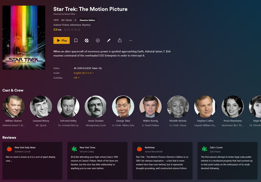

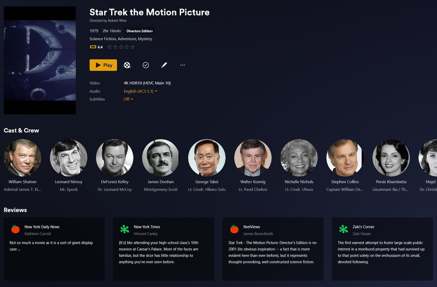

Using the new Plex Movie agent, and normal movies are matching fine- however special edition movies are only half matching (no summary or poster, yet has imdb rating, genre, cast, reviews, extras)
A quick “refresh metadata” correctly updates the poster/summary. No need to do any matching.

I’m running the new Plex agent- and the issue is occurring on newly added content.
Happens even when I upgrade/replace existing content too.
The initial conversion to the Plex agent ran fine.

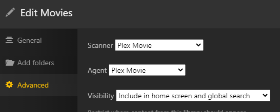

Just out of curiosity, what do you see when you go to the edit library dialog then advanced settings for scanner?

I have the same settings it seems:
