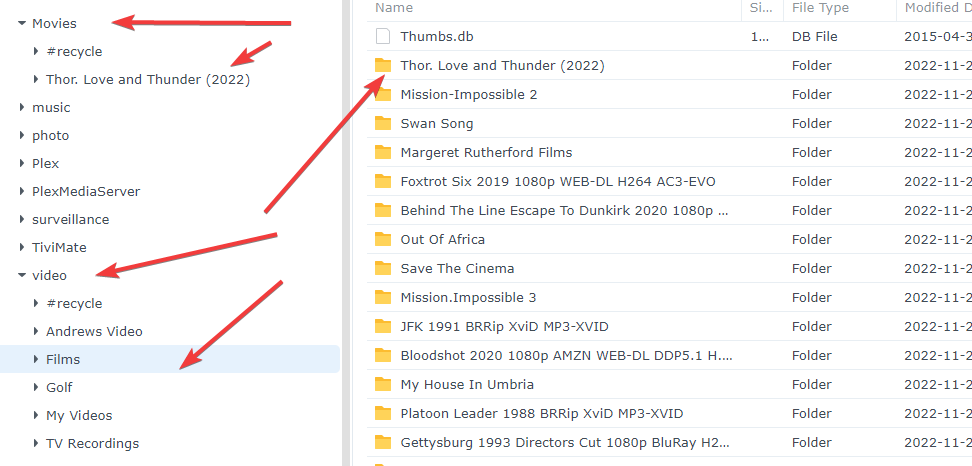

What I do have is a media shared folders on my NAS that I created prior to getting PMS and on my NVS I can play the same films OK. I am attaching a screenshot from my NAS folders.
Now the shared folder called Movies with Thor in, is the one I created using the procedure Chuck showed. That is the one where it will not play on TV via NS. However the lower version in the shared folder of Films which is a sub folder of Video, does play via NS on my TV which puzzles me.
