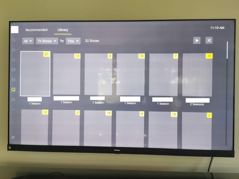

Still cannot get thumbnails to appear in libraries + shows
Server Version#: 1.30.0.6486
Player Version#: 5.52.3 (Plex for VIDAA)
Thumbnail pictures in Plex-for-VIDAA don’t appear (thumbnails appear as frames with unread counts). Happens when viewing libraries and when viewing shows. Plex on FireTV pointing to the server displays thumbnail pictures. Web client (same server) displays thumbnail pictures too. It’s just the Plex client that doesn’t display thumbnail pictures.
Pls help!
What the library looks like:
and what a show looks like:

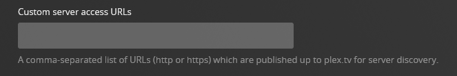

Did you put something into
Settings - Server - ‘Show Advanced’ - Network - “Custom server access URLs”
or is this field completely empty? (it is by default)
hi there - thanks for the reply
The field is empty - should it be empty?
custom server access URLs
Unless you have an unusual network topology, it should be blank, yes.
Different client types can contain workarounds for this type of issue. It’s pretty common, so don’t discard it right away.
