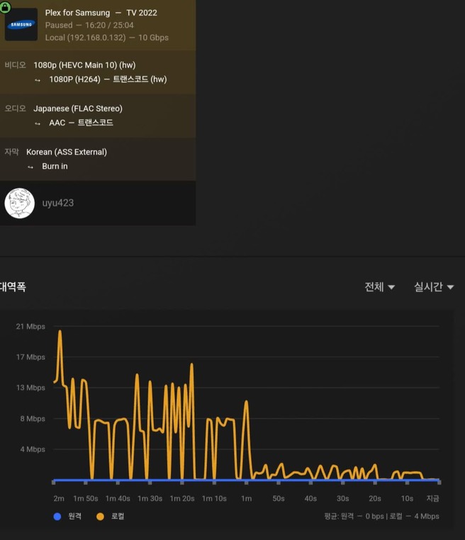

The screenshot below shows the bandwidth from the Plex Dashboard at the time the issues occur. There is a significant drop in transfer rate beginning at the point of disruption, with the affected video’s transfer rate being 8.5 Mbps at 1080p.

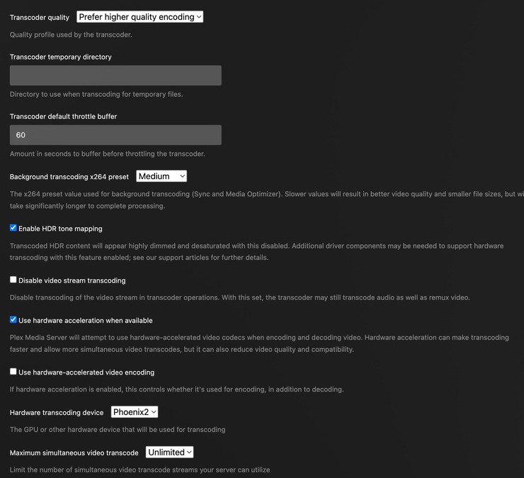

As a result, I found out that the above issue started after I started my Plex Pass subscription and enabled the “Use hardware acceleration when available” option.
My server specs are AMD Radeon CPU (AMD Ryzen 5 8500G w/ Radeon 740M Graphics) and I do not use a separate external graphics card. I know that if I enable the hardware acceleration option, it uses the CPU’s built-in graphics. (I am not sure if the same issue occurs with Intel or Nvidia products.)
Anyway, after doing some tests, I found that the above issue disappeared when I enabled the “Use hardware acceleration when available” option and disabled the “Use hardware-accelerated video encoding” option.
I have been using it for a few days now with the “Use hardware-accelerated video encoding” option disabled, but the same issue has not occurred.
