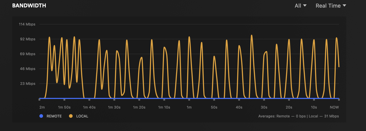

Then inspect the Plex dashboard during “Original Quality” playback, to get an insight what exactly is happening.

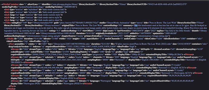

Please do also post the first ~20 lines from the Plex XML info of an affected video.
I noticed that the first significant dip at the 1 minute 40 seconds mark coincided with the occurrence of the first stutter. There was a short recovery, but then another stutter occurred around the “now” timestamp. However, I also observed that not every dip in the graph correlates with a stutter.
Since I can’t directly post the XML file here, I have taken a screenshot of it instead. Please let me know if there is a specific part of the XML that you need that is not visible in the screenshot, and I’ll be glad to provide it in my reply.
Try remuxing the file, this time dragging the AC3 audio track above of the TrueHD track.
Do you mean that I would then need to convert from MKV to MP4? If so, which tool can I use for that? As mentioned previously, to my knowledge, MKVToolNix can handle MP4 to MKV conversion, but what about the other way around?
no, just use mkvtoolnix. only switch the ac3 track as first audio track.

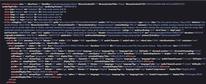

This is the file with the 5 seconds issue:
But I don’t really understand how and even why changing the audio track would fix that issue for that file to be honest. Could you explain how changing that fixed one of the issues?
