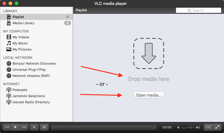

Hey how’s it. What I meant was VLC is a player like Plex is a player.
I’d like you to exit out of Plex. We won’t be using it for this test.
When you go to videolan.org, download, and then install VLC onto your computer,
it should appear like the rest of your programs on your Start menu.
So you find VLC on the Start menu and click it to start it up.
You should get some small window with a file choosing screen.
Open the Parks and Recreation media file that we’ve been talking about
and have VLC play that.
Tell us if the subtitles appear like I described above.
That make sense?
