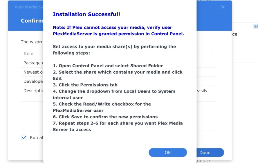

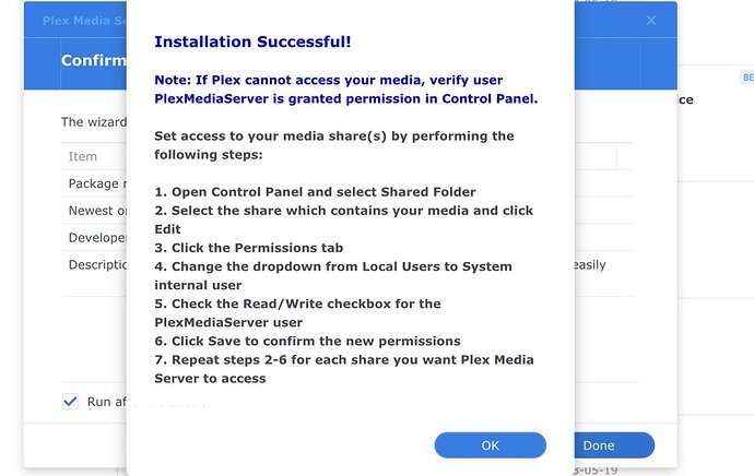

Using DS418 Play. I updated to DSM7 yesterday without following the instructions outlined in these threads, I wish I had thought to check first but I didn’t. I honestly didn’t think anything of it. It just said update and I did. The process seemed successful. There was a button to repair which I clicked and I received the attached message at the end. I screenshot it so I could refer back if needed as I didn’t have time to check at that time.
And now I can no longer access the server. I think the error message may have said something else earlier but now it is saying Synology Nas Plex is currently unavailable.
I have changed the permissions on the folder to read/write which didn’t work
I have changed the permissions on the folder to custom and read write and applied it to all sub folders and it didn’t work either.
I am applying these changes to the folder I store all my media in (for me this is called media) and to the Plex and the PlexMediaServer folder. I have also rebooted the Nas several times with no luck.
I’m really at a loss now. I wish I had known to follow these instructions before I installed the update.
Do you still have " Plex / Library / Application Support / Plex Media Server" ??
If you do -
  1. Uninstall the DSM 7 package with the ERASE option (it’s a roge configuration
  2. Now reinstall AND follow the instructions.
When you’ve got it working right, it will sit at “Installing” for a while until completed.
( The Plex share will be empty. It will contain a ‘Migration.log’ file showing you everything it did )
