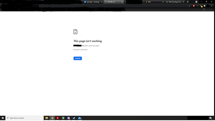

Just updated to DSM 7 on my Synology 718+ and after installing the latest Plex Server it now wont open when I try through the Package Center. I can go to Plex.tv and open it that way and have all the same controls but its just annoying it wont load through the Synology.
it comes up with “Page isnt working” “(ip address) didnt send any data”

Do you have the local firewall turned on, on the Synology?
I am having the exact same problem. I have tried the mode 2 reset and reinstalled Dsm and a fresh install of Plex from their website. Still same problem. Oddly enough Plex is still running and works fine on the mobile app and Apple TV app. I just can’t log into the app on the dsm. Please help. I’m wanting to use the live tv and eve function but I can’t get this figured out.
Well in the process of getting my logs I figured out the problem. I was able to log into plex via the website. I went to settings>network and under the enable server support for ipv6 i changed it from required to preferred. Saved it and all is good now. Thanks Trumpy81 for the help.
