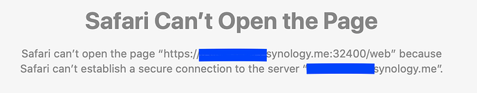

PMS is running, but when I select it to open, in Safari and Chrome browsers, I get:
I’ve done all the delete the app, share, user, shutdown, reinstall, enable, several times to no avail. Tried disabling UPNP, with (and without) port forward from NAS to Router, which failed as well. Again, 32400 is open on the router and verified with an app.

I disabled DDNS, and tried to connect by manual entry of the LAN & WAN side URL addresses. Still got the same no-go window. I found that the default link address in Package Center’s Plex panel was still the *.synology.me:32400 until I went through the uninstall process again. So went through the entire delete process again: uninstall Plex, delete the Plex share, delete the user, restart, manually installed the package (without the run checkbox selected at completion of the install). Then enabled the share and users, and then started Plex. Following reinstallation, the URL was now my NAS LAN address:32400, and got connected.
From a testing side, I wanted to find out if after Plex getting the correct URL link in its’ Package Center window, if I could re-enable DDNS. I tried it, and it failed again. As soon as I re-started Plex, the URL link changed to the *.synology.me:32400, I was back to the “can’t open the page” screen.
Is there a way to change that link without going through the reinstallation process? Where is Plex assigned that URL from?
