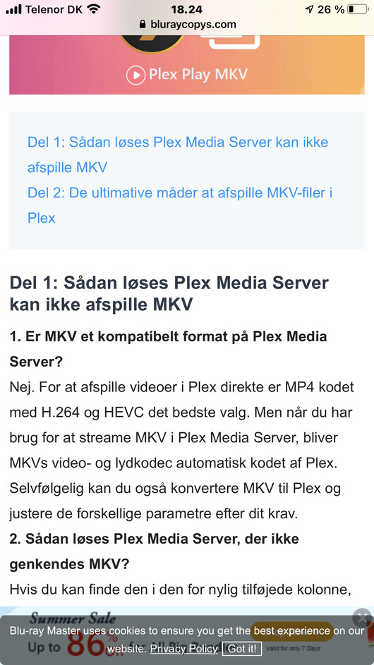

Look here. Mvk is not Good.

I Can translate that. No Mvk is not fine.
Part 1: Solving Plex Media Server cannot play MKV
  1. Is MKV a compatible format on Plex Media Server?
    No. To play videos in Plex directly, MP4 encoded with H.264 and HEVC is the best choice. However, when you need to stream MKV in Plex Media Server, MKV’s video and audio codec is automatically encoded by Plex. Of course, you can also convert MKV to Plex and adjust the various parameters according to your requirement.

The only client that does not suport mkv is the web player. You said you were using Plex Media Player which plays them fine. whoever wrote that does not know what they are talking about and is making generalizations because they are not bothering to figure out the real reason
I suggest you look at your logs and stop making random guesses
