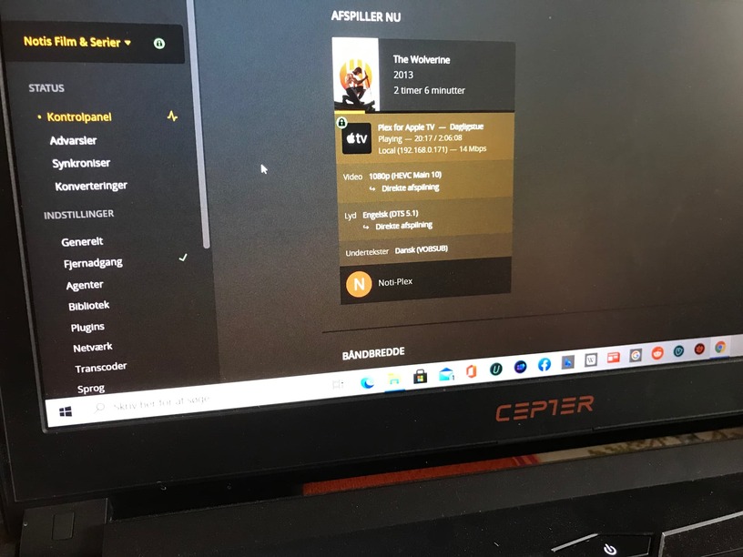

Look. Dashboard Will not help.

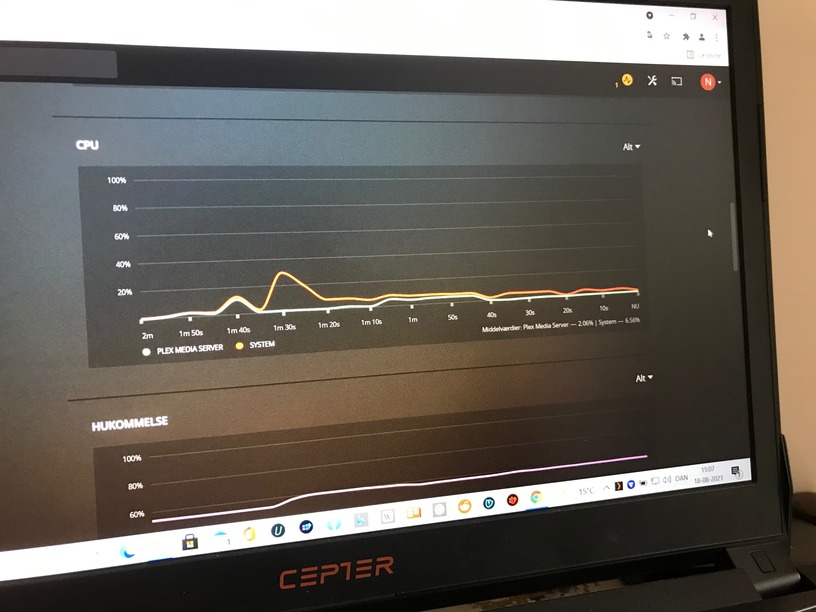

As you can see it is doing “Direct play” of that file. No transcoding needed so it is NOT your cpu that is giving you problems (Assuming you always see this “direct playing”)
But again - it is not because you need a bigger cpu. so thats out of the question
Is this a image of you playing a problematic movie? It says playing so what is the issue with playing this movie?
Will do it agian in danish to awoid any language barrier
Som du kan se pĂ„ billedet laver den “Direkte afspilning” af den film. SĂ„ ingen transcoding er nĂždvendig og derfor er det ikke din cpu der giver dig problemer. (Forudsat at du altid ser “Direkte afspilning”)
Og igen - hvis du ser “Direkte afspilning” er det ikke fordi du skal bruge en bedre cpu.
Er det her et billede, hvor du afspiller en problematisk film? For der stÄr den afspiller sÄ hvad er problemet med afspilningen med denne film?
Hvad er det sÄ der er galt?
“What is it then that is wrong?”
Yes, what is wrong with the playback? It says: “Playing as status in the picture you provided” so is it not playing? is it choppy? I don’t understand what the error you are experiencing in the picture you provided? Is it here it pops up with the message about the connection is not strong enough?
Ja, hvad er der galt med afspilningen pĂ„ det billede du sendte? Der stĂ„r “Playing” sĂ„ afspiller den ikke eller hakker den eller? Jeg forstĂ„r ikke helt om du oplever fejl pĂ„ det billede du sendte? Er det her den kommer med den besked om at forbindelsen ikke er stĂŠrk nok?

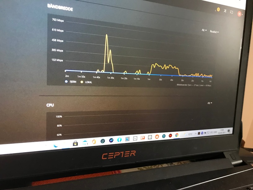

From what I’m seeing in the logs your settings are correct in terms of direct play.
But some of your files are pretty big
Content-Length of E:\Film\xXx3.1080p-Danishbits.mkv is 2808879463 (of total: 12155071473).
Are both your Plex server and the Apple tv on wired connections?
Fra hvad jeg kan se i din log er dine indstillinger rigtige. Dvs den laver direct play.
men nogle af dine filer er lidt store
Er bÄde din Plex server og dit Apple Tv pÄ kablede forbindelser?
Ja, de er kablede forbindelser
De er pÄ kablede forbindelser
