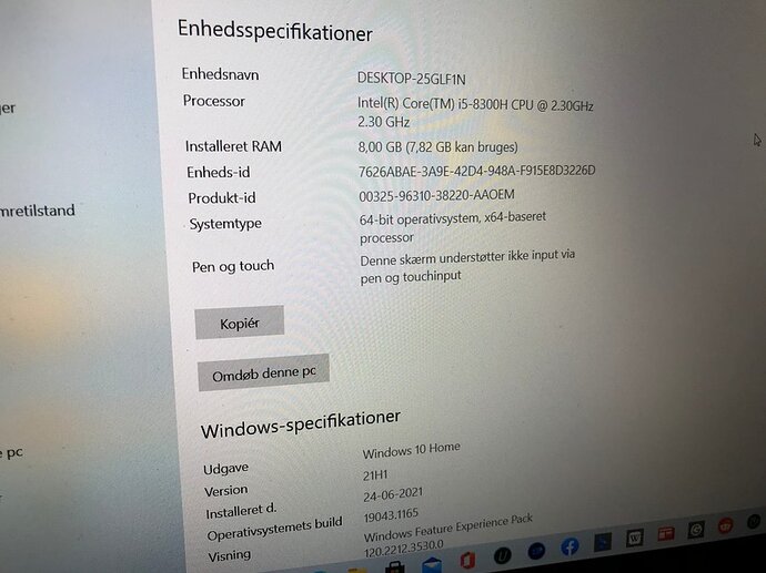

Now it takes a hell of a long time again for the movie to move on when I jump to the next chapter. And sometimes it does not. What the hell is going on? Is it because it just needs to get started in the first place? It also stops. No, honestly, do I really need a dedicated Plex server? I do not have enough cpu?
This is my CPU:
Is it because Plex is just getting started?
Like I said before, your streams are probably trying to transcode and the computer isn’t strong enough to do that. Try setting local and remote quality to original in the Plex app and report back the results.
