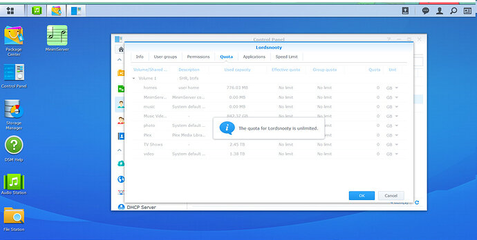

Thanks again for all your help. I did what you said and went into Group and users and checked all users and all of them came up with the same thing that my quotas are unlimited

I couldn’t find the problems of quotas in Plex Users…they were as I said set at UNLIMITED
Which got to me thinking that I saw somewhere about quotas and it wasn’t in File Station but in Shared Folder under Plex. and in ADVANCED somehow a quota had been set …honestly I don’t how I did that or why did but once I unticked it and I tried Plex and it is running
