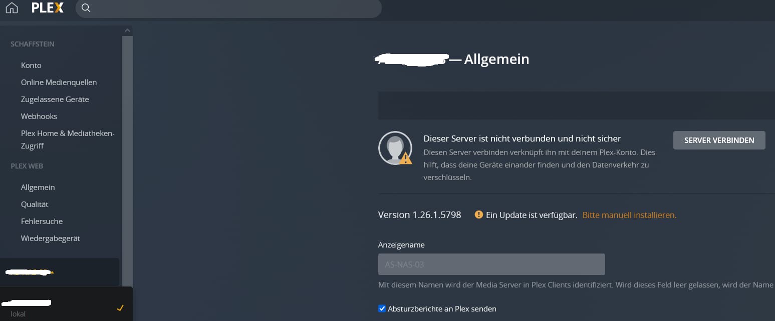

I upgraded a while ago to DSM7 and everything seemed to be ok. Suddenly I get this “server is unclaimed and not secure”. After various tries I panic and deleted PlexMediaServer completely and then installed it again. During the installation process i was asked to add me media folders which I did but eventually when I open Plex in my brower I still get the “server is unclaimed …” status.
I can see that my media is indexed and meta data added in the background, building the database so the server is actually running. The permission for internal system user I checked and are corrctely set. I also deleted now the old (already empty) Plex share and Plex user. I saw some posts referring to DNS issues (no idea what to check here) but since everything else is fine I doubut that.
I have not changed anything on my browser, Router. I need help ! NAS is Synology D418play with Inter CPU. Please help
Latest Version installed. Claim server button has no effect.

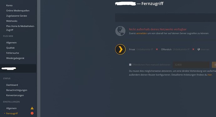

Also wondering that remote access is apparently not possible:
If claiming the server has no effect, the most common cause is the Synology can’t connect to Plex.tv
