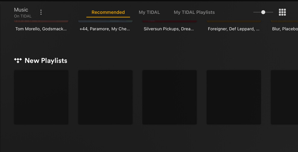

Also in the web app it looks with black boxes, could it be that not able to load this hub, is bringing the whole Tidal home in plexamp?

Could this be related to Tidal API changes on the Tidal Side?
Early indications are that the TIDAL API is returning invalid JSON in some cases, but we’re still investigating.
A cloud fix is rolling out, and we’ve. made additional changes in the next release of Plexamp to make home screen loads more reliable.
