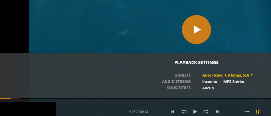

1 pictures are better than a long speech.
I read directly from google chrome, I do not have a dedicated PLEX client.
But what is weird but very weird what for the same video “the chronicles of Shanara” in this example.
(and I’m just doing the play button)
The video loads without problem on the rpi3 and not on the tinkerboard. On the tinker, I have the wheel and it blocks at 30 sec of reading on the tinkerboard.
(I still specify that the plex configuration is identical on the 2)
And for the install, I actually installed the ARMF so 64 bit and I have a lot less problem than with the ARM but I overclock too high the tinkerboard processor and now I have the same power the rpi3 and then more worries. (In part of my fault But I confirm that it heats more since I use ARMF)

That’s the worst possible client. It often requires transcoding, “conversion”. If you really want to use the Tinkerboard or RPi as Plex Server, you really cannot use the Web Client and Auto-Play. Always use “original” quality and a real plex client. Otherwise, you will have to use a x86 server with more processing power.
Then most likely, you have different versions of this video on both devices. The file on the RPi3 is directly playable in Chrome while the version on your Tinkerboard not. Or you have different “quality” settings for both files in the web frontend.
