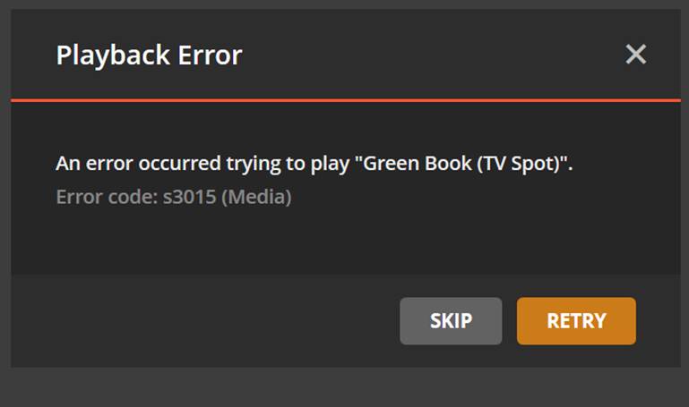

Web continues to give me this error on all trailers:

I was simply adding the statement that the “Web continues to give me this error on all trailers” to point out that the web interface does exactly the same thing as PMP in desktop mode; all trailers get cut off at random times towards the end of them.

My confusion was trying to understand what the issue is with Plex Web (the web page). You say that when using Plex Web, you get the Playback Error you posted above.
But then you also say that with the web page you get the same behavior of the trailer not finishing as you do with PMP.
So when using the web page, are you getting the Playback Error message or the trailer not finishing? Or is that error message what you see when the trailer stops? Just trying to understand if that error is something else or related to the trailer not finishing.
