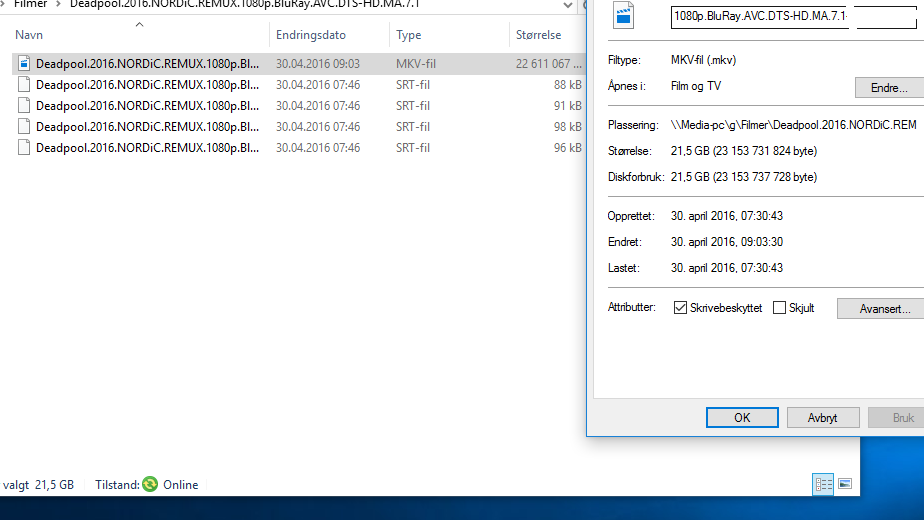

Hello, i have recently started using the plex on my samsung 2015 model Tv. So much better quality than on the pc.
But my some of my files are transcoding, this tv supports almost every fileformat, so i have no idea why it does that. Could someone I have taken som screenshots if that helps.
http://www.samsung.com/us/support/answer/ANS00046441/
Is it because the tv doesn¨t support SRT files, if so is there anyway to burn them into the mkv file for instance. If this is possible, is there any way i can do it with multiple movies at the same time? Would take a lot of hours to do this to 500 movies…

@trumpy81 said:
If you are using subtitles then that may well be why the files are being transcoded. You can use Handbrake (PC/Mac) to ‘burn’ the subtitle into the file, but be aware that this makes the subtitle permanent. You will not be able to turn off the subtitle nor will you be able to change the language or the timing of the subtitle in any way, so make sure you have the correct subtitle and that it is timed correctly.
You can use the batch function in Handbrake to re-encode the videos with subtitles for as many files as you wish to add.
Also, judging from your screenshot, you need to correct your file names so that they follow the Plex file naming guidelines. This will help avoid any issues with adding files, matching and downloading metadata etc.
Try using FileBot to automatically rename them.

But should i rename the folders and movies like this? folder: deadpool 20; mkv file deadpool 2016; SRT file deadpool 2016.EN ?
Absolutely not.
This is all laid out in the media preparation guides:
https://support.plex.tv/hc/en-us/categories/200028098-Media-Preparation
Stick to it, or you’ll end up in a world of pain.

!update! I can now stream atleast deadpool at directplay. The mkv had inburnt and external subs. I deleted the external srt files to make it look more clean. Haven’t changed anything regarding audio either. 5.1 surround works through ARC. Everything is working really smooth so far :slight_smile:
There is one small hicup. i have 4 languages burnt into the mkv. It seems like i have to change between them a few times to make it change the language. When i started the movie i choose norwegian subs. When the movie played it was danish subs. Went into settings and it stod norwegian subs. Changed around to sweden etc. Changed back to norwegian and it now started giving me the right subs. Exited the movie and tried to play it at the same time i left it on. Started playing, but now with danish subs. Checked settings and it stood danish subs. Changed between swedish and norwegian subs, and it started displaying norwegian subs again. Is there a fix for this? or just a bug?
update nr 2. It still plays directplay with external SRT files named correctly. I guess the transcoding yesterday came because of the weird names on the files.
