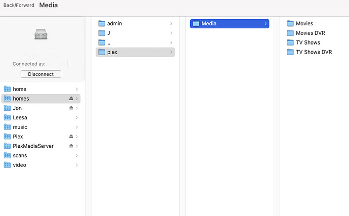

This is what my folder structure looks like right now:
The folder that says “Plex” is empty and I must have created that during installation.

I would very much appreciate some help with this or alternatively, pointing me to some directions or documentation that could help me out. Also, can I get myself into some really problems doing this or is this a common task that is accomplished without much difficulty? Thanks for your help! It is greatly appreciated.
IIRC the Plex / PlexMediaServer shares on your Synology are restricted to be used by the system user, used by DSM to run the server. As an admin on your Synology you can grant yourself access to those shares. This can be helpful if you need to manually collect some server logs.
As the names of the empty files in those shares indicate, they’re not supposed to be used for your media. There’s various threads of users who got their servers messed up by placing their media files in those shares. As usual, things might not break immediately but they will certainly break over time.
TL;DR: don’t place your media in those shares!

ChuckPa, in your Technique 1, step 3, can I move my folders since they are the same folders that you advocate creating from scratch? If I can do that, should I copy those folders and the movies, tv shows instead of moving them…just in case something doesn’t go right and I will still have the original copies to fall back on? Thanks for your help!
@photogman551
Did you create Media under plex? or ? I’m not too familiar with the view you’re showing me.
If we can look at this using the Synology FileStation, it will avoid any confusion on my part (I’m a Linux guy).

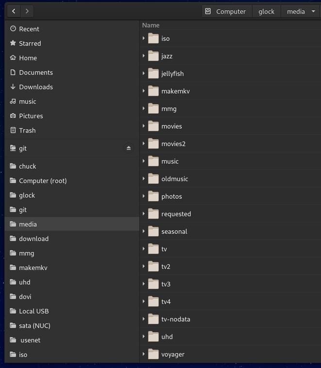

On my Linux machine, Technique 1 looks a little different but is this:

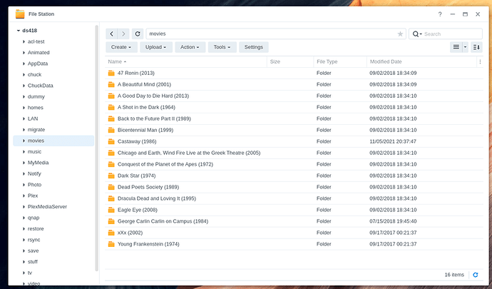

I copied some files to my DS418 (DSM 7) so you can see what it looks like.
  1. Created shared folder movies
  • PlexMediaServer has permission to Read
  • I have permission to Read/Write
  1. Copied the movies into movies shared folder
