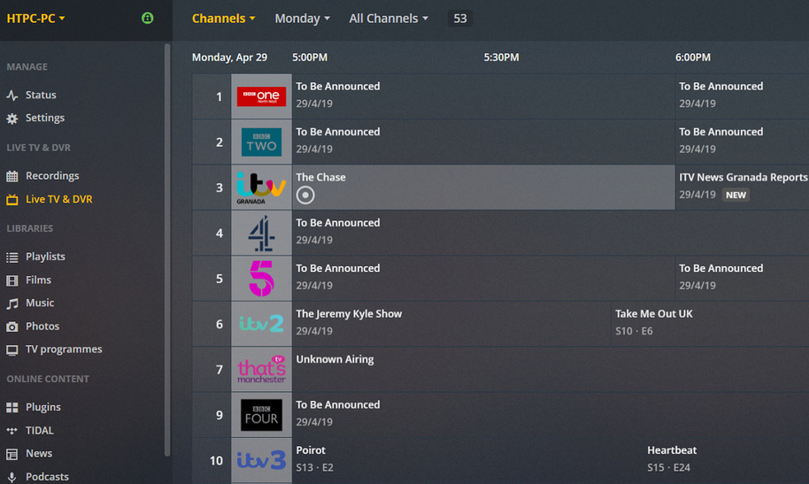

TV listings not updating overnight mostly for BBC. Full refresh suceeds
Every week the TV Guide fails to update for mostly just the BBC channels - ITV ones seem fine
A full refresh
Settings>Manage>Live TV & DVR> Refresh Guide gets all the listings in
But the nightly maintenance/update continues to fail most night
I have turned full logging on and attached the logs
Also screenshot of what is typically showing in the guide for a few days out onwards
Any additional information required let me know
