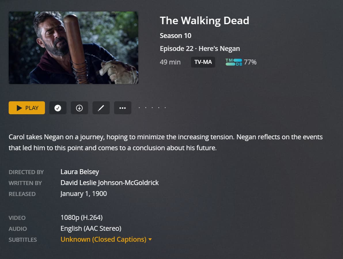

TV Media showing RELEASED as January 1,1900
Version - 1.33.0.2444-a220eae4
Running on Windows 10
Long story short is I lost my Plex server due to lightening. Had to restore from a 1 year old backup copy due to losing other backup copies. Updated to the latest and had to add in / reanalyze my media. Other than recently added (ex now added media since its been restored and running) newTV shows everything else shows a release date of January 1, 1900.

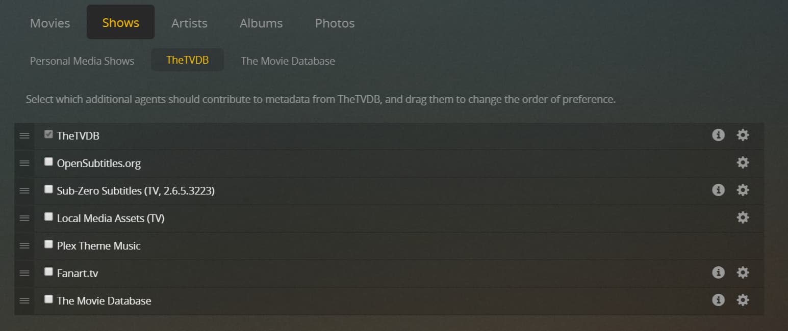

Current Agent settings -
Example of media dates wrong -
Example 2 -

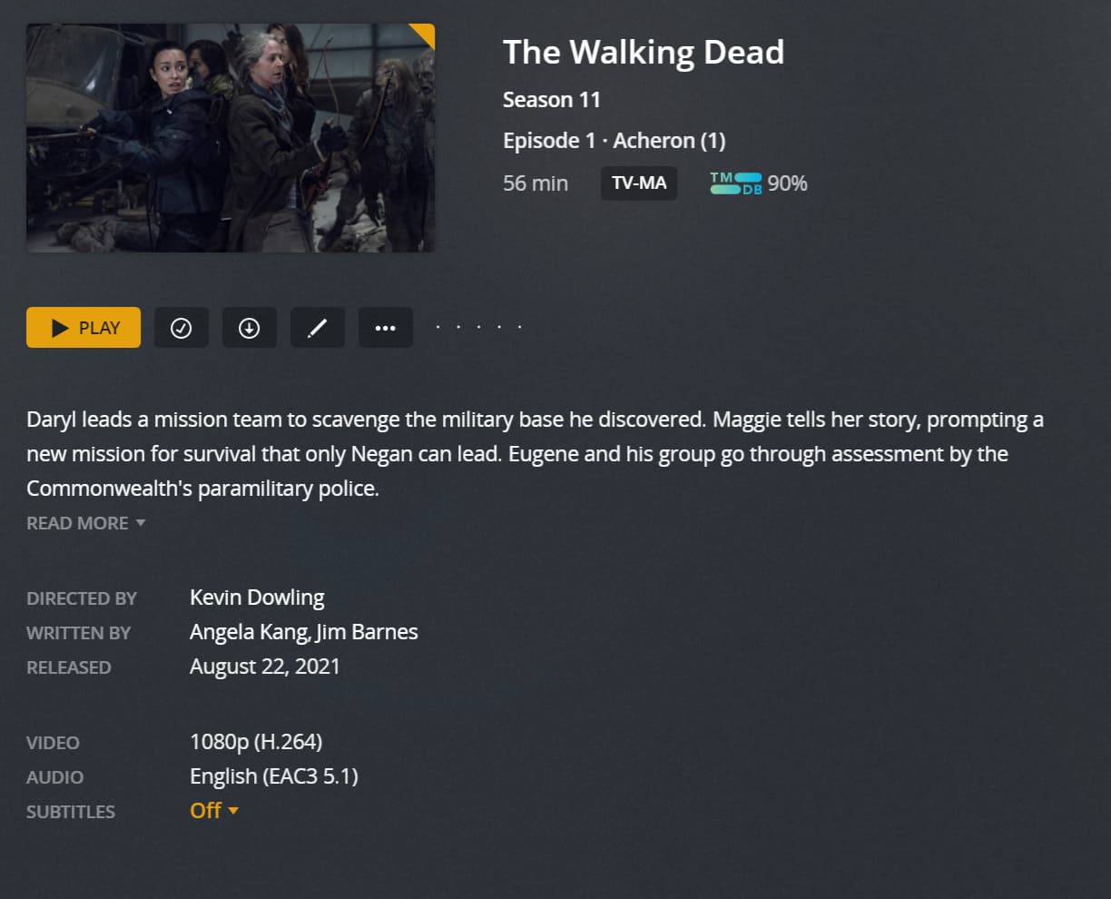

Very recently added is ok-

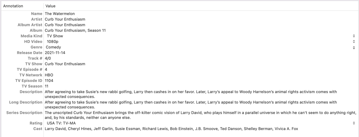

I have an example. I always pre-tag my files (using Subler which retrieves from thetvdb.com) but get the January 1, 1900 in Plex for some.
Here is the embedded metadata for a file:
