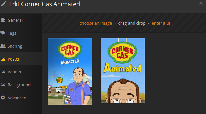

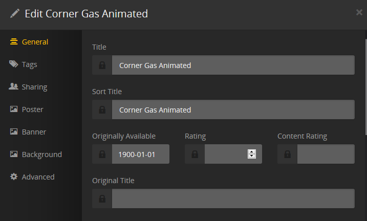

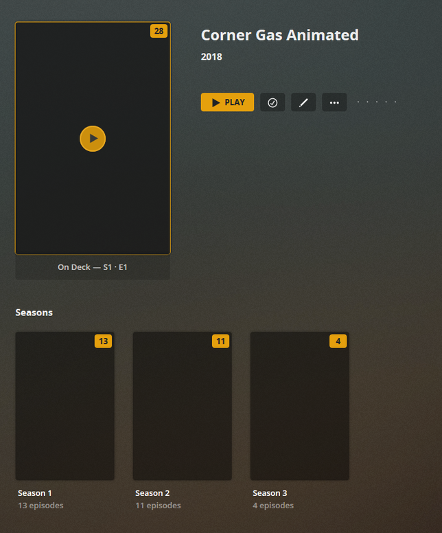

Basically, it refuses to scrape things properly for TV Shows, it will get the Title + Year, won’t get dates, or set the Poster. I can set it manually (Posters will populate properly).

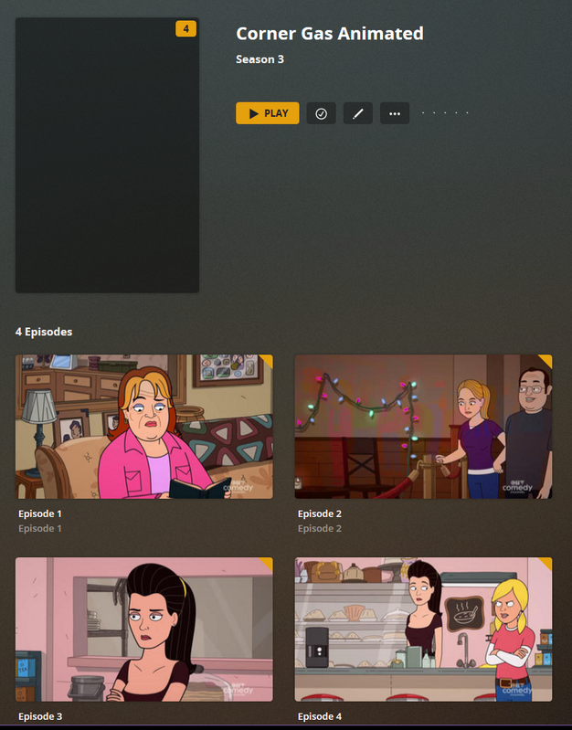

At the same time, 99% of episodes will be Episode #, and some will randomly / magically have a Episode Name.
