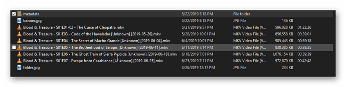

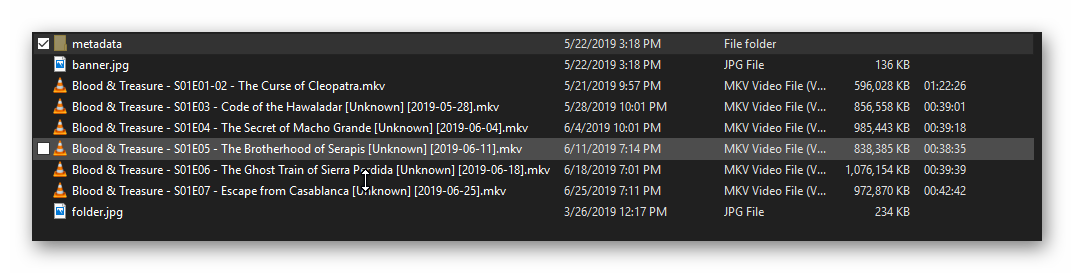

Here’s the log files from the server as well as a screen shot with all the files listed.
