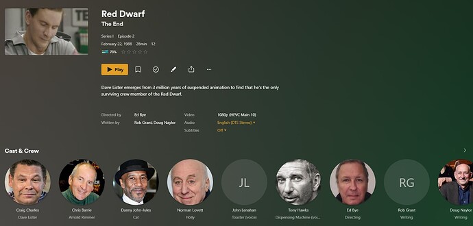

See below the screenshots from the show level
At the episode level
and at the show level
What is odd is the episode number and the episode date are correct and the TVDB rating is correct!! but the title and other elements are wrong
