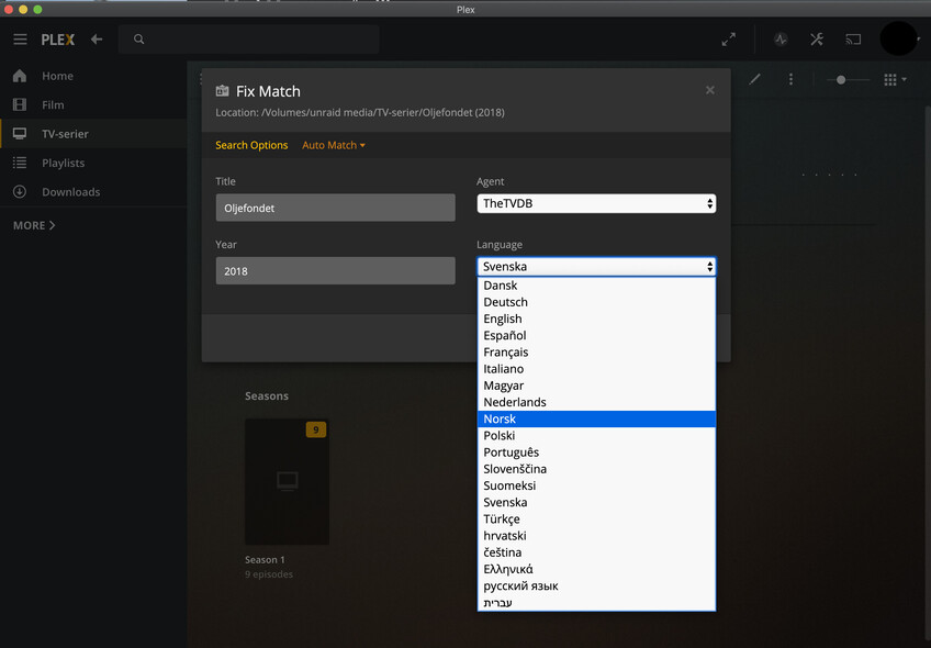

Then I click “Search Options” and choose “Norsk” (Norwegian) in the “Language” menu. Notice how the title is already “Oljefondet” since that is the Norwegian title and what I’ve named the files. Hit “Search”.
Here comes the banging my head into the wall part. No matter what I do, or how I search, it always returns the English entry. Always!! :triumph: :pensive:

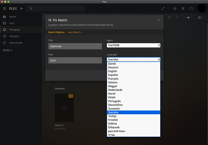

But (!) if I choose to search for the Swedish entry (Svenska) instead…
…it works like a charm. Like it should!

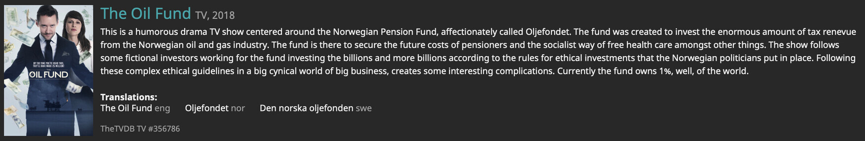

This is the entry on theTVDB
