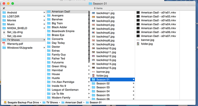

TV Shows\American Dad!\Season 01\American Dad! - s01e01.mkv
TV Shows\Boardwalk Empire\Season 1\Boardwalk Empire - s01e01.mkv
I picked those as they are slightly different - the second one doesn’t have an ‘0’ in the Season number. But neither of the above are showing up, so I’m thinking whatever it is that’s breaking it is somewhere else.

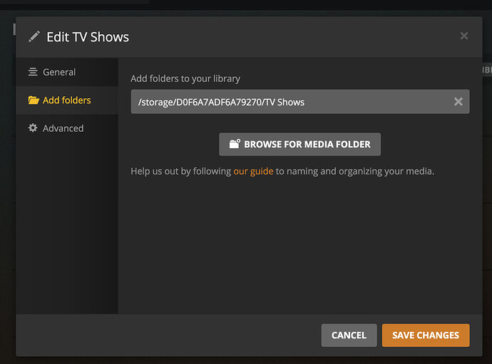

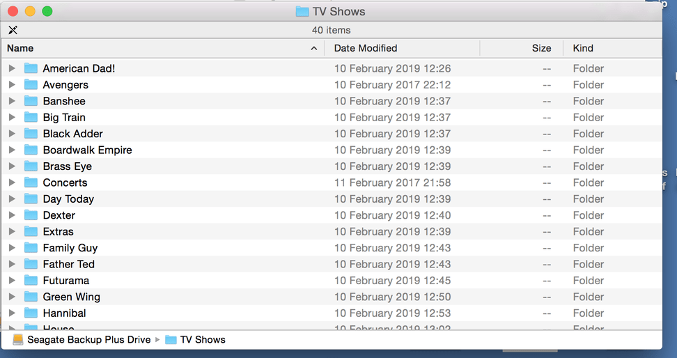

Hi there.
Thanks for the reply. I’ve attached some screenshots of the path I’m taking / name of the folders. Hopefully that will give you a bit more to go on.

Is your Plex Media Server also running on that Mac or is this just the external drive you’re using with the Nvidia Shield?
No, the media server is a Seagate external drive, it was just on the Mac so I could show you the paths and structure.

hmmm… from the logs it seems the Plex Media Server cannot see/access the folder linked to this library.
Nov 05, 2019 19:20:56.900 [9778] DEBUG - Scanning TV Shows using en(Plex Series Scanner) with 0 current media items and 1 section locations in the database...
Nov 05, 2019 19:20:57.144 [9778] DEBUG - Performing a scan with 'Plex Series Scanner' (language: en virtual: 0).
Nov 05, 2019 19:20:57.144 [9778] DEBUG -   * Scanning /storage/D0F6A7ADF6A79270/TV Shows
Nov 05, 2019 19:20:57.144 [9778] DEBUG -   * Marking media not available in /storage/D0F6A7ADF6A79270/TV Shows

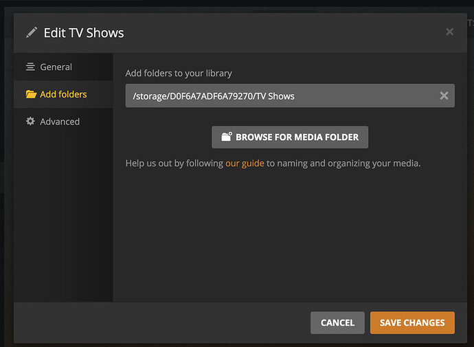

  • I’m able to navigate to what I assume is the drive – it has the same path as the film and music libraries so I think that’s the right one. I’ve attached some screenshots of the Add Folder tabs for each library.

When you edit the TV Shows library (... > Manage Library > Edit), go to Add folders and click on Browse for media folder… Can you see the subfolders of /storage/D0F6A7ADF6A79270/TV Shows?
This should show the same subfolder structure you showed from your Mac.

To your first question, no, but I have to manually add that path based on how movies and music are setup. There’s no way for me to actually see that path when I go to Browse Folders. I do see one that says /sdcard/TV Shows, but again that doesn’t show any further info.
As a test I pasted in the same path that’s used in Music to see if any albums showed up in TV Shows and they didn’t. Does the file type matter? Will it show up empty if the type is wrong, or will it show files but not allow me to play them?
