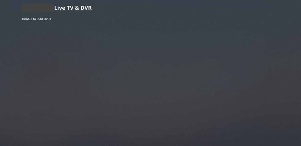

I can’t delete the DVR, as the first screen is as attached - it then takes me to the set-up screen. No option to remove.

It does look like a time-out issue. When I first go to the page, it tries to find the device - spins for a few seconds, then comes back with “Unable to load DVRs” and then redirects to the ‘setup plex DVR’ (as it should)
