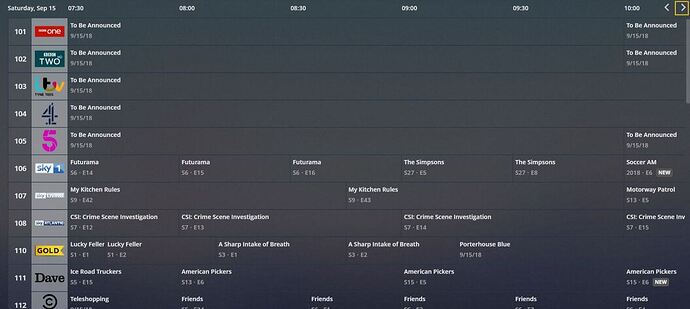

I’ve started seeing that the main terrestrial channels here in the UK (BBC1, BBC2, ITV, Channel 4) are only giving one week ahead in the guide.
BBC1, BBC2 and Channel 4 are only showing 7 days ahead (including today). After that, they show “To Be Announced”.
ITV only seems to be showing data for the coming week, ending on Friday (today is Monday). Either that, or it’s only showing 5 days ahead (including today).
I used to get 14 days ahead … what’s changed?

Last night i looked at my recordings and I had nothing scheduled today (Saturday 8th) at all and then when I checked nothing was due to record till next Friday 14th… When I look at guide data it is like above To Be Announced. After Friday 14th Data looks fine…

It is stuck on 100% Guide Data processing and not showing any guide data except “to be announced” on Saturday and Sunday for the main 5 UK channels…
Very odd
I too am seeing this issue here in the UK…
Today is Friday and if I look at Saturday evening it is saying ‘To be announced’ for the main UK channels e.g. BBC1, ITV etc. There are a lot of channels that are ok, but get worse as you go further ahead.

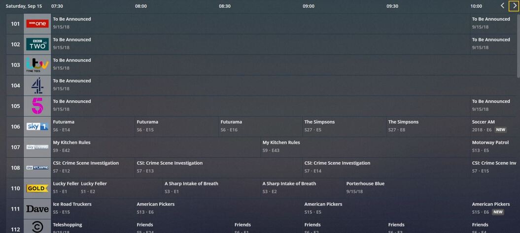

it’s SUN evening right now and for all channels the guide shows “to be announced” for programmes starting on SAT 06:00 and after.
Just noticed that the guide is only showing today’s programmes. For tomorrow from 06:00 onwards it only shows “To Be Announced” for all channels.
