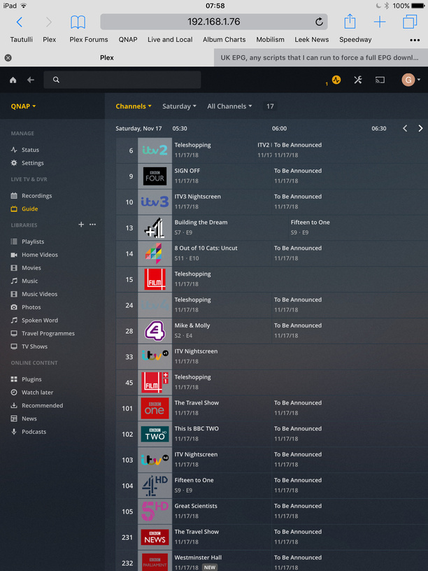

This morning I have “To Be Announced” from 6.00am on Saturday. Screenshots and Logs uploaded. I will do another screenshot/upload this afternoon and this evening as Plex should have tried to update the EPG further over these periods. If you require anything else let me know.
