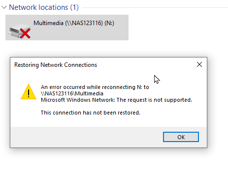

i changed the name of the media library back to what it was before QNAP support changed it
now i’m i’m getting the error message below
i also tried to access the network location and received this message
