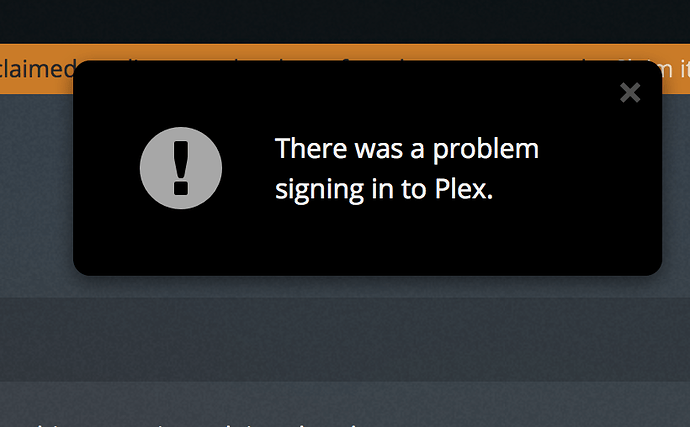

I’m getting the message “This server is unclaimed and not secure”.
Clicking claim server eventually gives popup “there is a problem signing into your account”
When I click the user icon (top right) I can see I’m signed in.

Asked me to sign in but the this popup
Thank you for that.
That’s a connectivity issue between DSM and the internet OR a problem with the Plex share.

I think that must be it, will look into connectivity of NAS and net…will keep you posted…
All working, there was a connectivity issue as you said.
