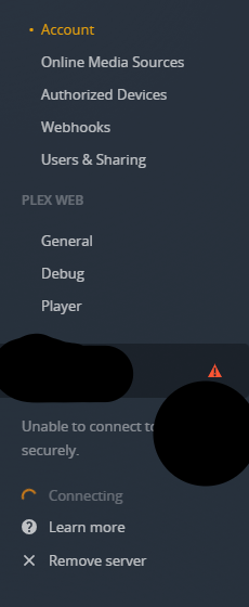

Unable to connect to plex server using plex.tv or the desktop app. However I can access my server when using the app on smart tvs or consoles. I have tried resetting the server and my NAS but still no change. Been trying to troubleshoot all evening but no luck :confused: Please help!

I am still getting an error, though now it is saying that the server is unreachable, or it’s even attempting to connect to the server. I’ve attached a screen shot and an updated zip. Logs.zip (2.2 MB)

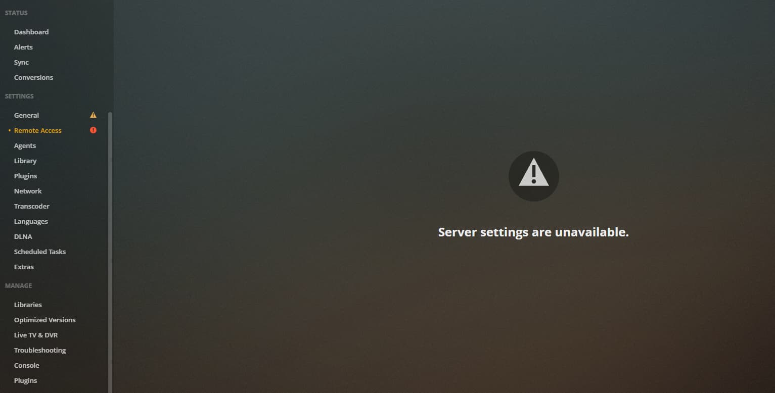

When I try to access http://Your_NAS_IP_Address:32400/web. It shows my libraries however when I go to view them it says that I need to claim the server. When I do this however it either won’t claim the server and simply says that I need to install the newest version of plex ( and I have also uninstalled and reinstalled plex on my synology NAS) or it says that server settings are unavailable.Logs.zip (2.2 MB)

Check Control Panel - Network - Network Interface tab - EDIT the network interface you’re using
Check the DNS value there and make sure it points to the modem/router (if setting manually) or DHCP which will set it.
The failure you’re having is because the server can’t connect to Plex.tv . Specifically, it can’t resolve the IP address (DNS lookup failure)
Sep 28, 2021 18:59:28.390 [0x7fa18a131b38] ERROR - [MediaProviderManager] Error issuing curl_easy_perform(handle): 6
Sep 28, 2021 18:59:28.390 [0x7fa18a131b38] WARN - [MediaProviderManager] HTTP error requesting GET https://plex.tv/media/providers?X-Plex-Token=xxxxxxxxxxxxxxxxxxxx (6, Couldn't resolve host name) (Could not resolve host: plex.tv)
