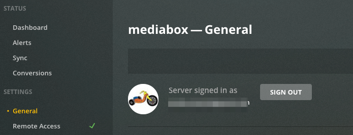

in the general settings of server it will show you as signed in. This is different than the web app.
Yes, it shows as signed in.
