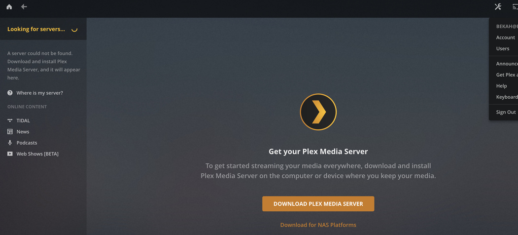

This is the issue I am having
My Cloud EX2 Ultra
I have been up and running flawlessly for over a year, I bought the Plex Pass on Black Friday and the next day (without changing any settings) started having issues, it was not seeing new movies I was loading onto my WD server. While on a business trip my home lost power, the WD rebooted just fine
(I can access the server directly) but Plex no longer sees the server.
after searching forums extensively I have turned off and turned back on the plex app ont he NAS, reinstalled older updates and newer updates, removed and reinstalled the PMS completely and made the mistake of removing the server from my Plex Dashboard. Prior to that is said my Server was unreachable now it just eternally looking for server and never finding it
I can access and play the media on the WD My Cloud EX2 Ultra, the issue seems to be exclusive to PMS
Since I have no access to the server I pulled the logs (I pulled them all) from the Mac iOS
Archive.zip (521.1 KB)
At this point I don’t even care if I lose everything - I just want the ability to use the program back.
